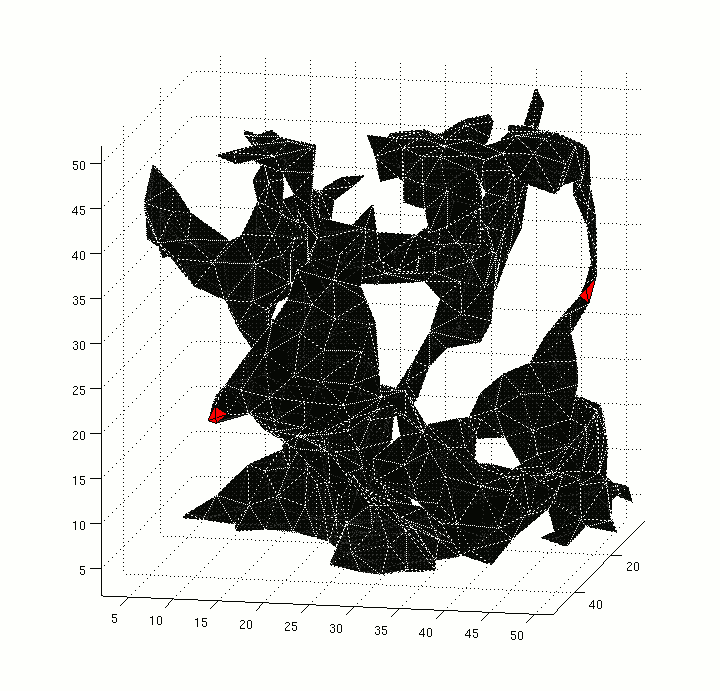

As an example, I attached an OFF surface mesh as the raw surface mesh,
to run the mesh simplification by
cgalsimp2.mexglx pre_remesh.off 0.05 output_mesh.off
(source code: https://orbit.nmr.mgh.harvard.edu/plugins/scmcvs/cvsweb.php/cgalsimp2/?cvsroot=iso2mesh
binaries: https://orbit.nmr.mgh.harvard.edu/plugins/scmcvs/cvsweb.php/iso2mesh/bin/?cvsroot=iso2mesh )
you will get a surface mesh with 8 intersecting elements (ID: 66,76,87,72,405,483,489,424)
the raw mesh and the simplified mesh plots are also attached (the intersecting
elements are highlighted by red color).
I am wondering if anyone who has similar experiences can give me
some advices, or share some code, on how to implement this feature
with CGAL?
