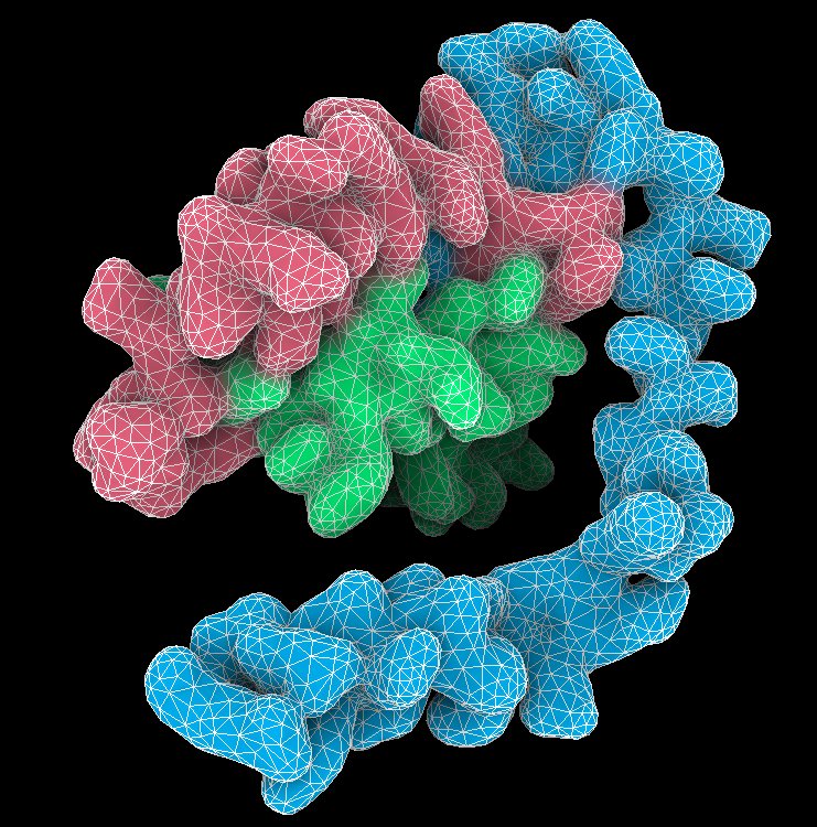

I'm using the CGAL surface mesher for meshing the surface of proteins.
The results are excellent (see image), but I have a speed issue:
- Linux, CGAL 3.7 : I get a surface with ~3600 vertices in ~2.1 seconds.
- Windows 7, CGAL 3.7, exact same source code : exact same surface
computed in between 30 and 53 seconds !!
