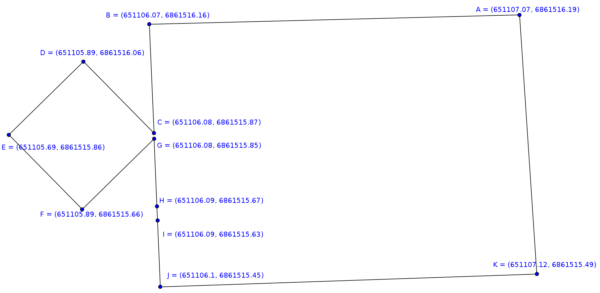

Good afternoon all,
Has anybody checked the code I posted ? I believe that this is a bug in exact number representation. Because when I use the double precision for representing the coordinates, it works.
Have a nice day
Murat
On Mon, Jul 1, 2013 at 4:52 PM, Myirci <> wrote:
Good afternoon all,
I've a simple polygon which CCW oriented and simple, but when I run the Straight Skeleton algorithm on this polygon, the program crashes. I put the very simple code in to the attachments. Could you please check if this is a library error or am I doing something wrong?
System Info: Ubuntu 11.10 32-bit, CGAL 4.2
Thank you very much
Inline image 1
Murat Yirci
