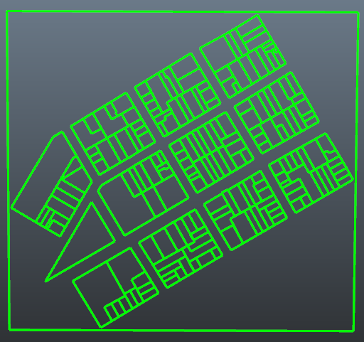

Initially, my CDT constraints auto-intersects, but I eliminate intersections using CGAL::compute_subcurves (using kernel CGAL::Quotient<CGAL::MP_Float>) on the constraints before the triangulation, as shown in attached figure (I thought it could solves the problem).

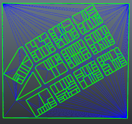

I got a valid CDT triangulation (as shown in the attached figure) but when I try to refine the CDT, using the method:

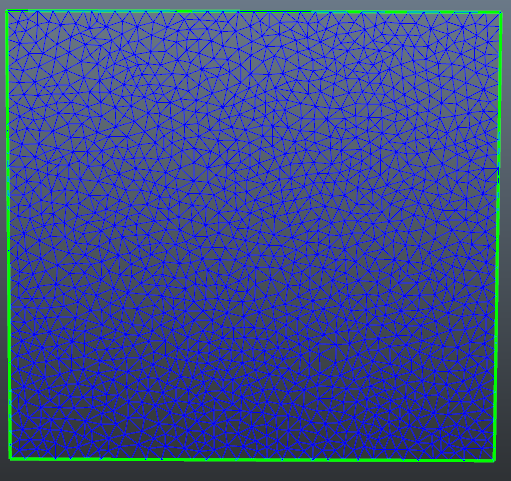

- Using only the boundary as CDT constraints, everything works fine (as shown in attached figure).
