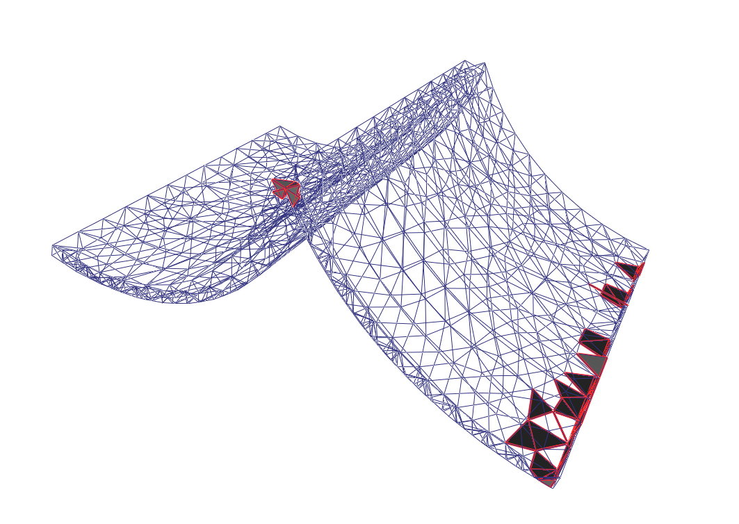

When I open you files in the CGAL polyhedron demo, it is telling me that
your meshes are polygon soups (meaning you have non-manifold edges).
If I duplicate those edges to make it a self-intersecting surface
I have the following set of intersecting faces.
Sebastien.
On 12/05/2017 05:22 PM, Sean Hardesty wrote:
I have a collection of meshes that overlap slightly, so I am going through a loop removing overlapping pieces. It works for a while, but eventually I run into trouble. I am calling PMP::corefine_and_compute_difference(CGAL 4.11) on a pair of meshes that satisfy
!CGAL::Polygon_mesh_processing::does_self_intersect
CGAL::Polygon_mesh_processing::does_bound_a_volume
and I get the following:
terminate called after throwing an instance of 'CGAL::Assertion_exception'
what(): CGAL ERROR: assertion violation!
Expr: hedge!=start
File: /usr/local/include/CGAL/Polygon_mesh_processing/internal/Corefinement/Visitor.h
Line: 663
Aborted (core dumped)
They are fairly small, so I wrote them to .off format and attached them to this message. I am aware from your documentation pages that there can be problems with sequential boolean operations, so I am using the kernel with exact predicates and exact constructions. Maybe the precision in the .off format is inadequate to diagnose the problem. I would be grateful for any help that can be provided.
Sincerely,
Sean Hardesty
Description: PNG image
