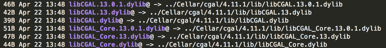

I had a look at the libraries linked at the end of the compile job, and I could only find one related to CGAL :
/usr/local/lib/libCGAL.13.0.1.dylib
There are a few other symlinks to CGAL libraries in /usr/local/lib:
Could this linker error be explained by the fact that these other .dylib are not included?
