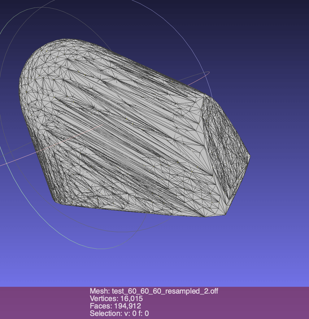

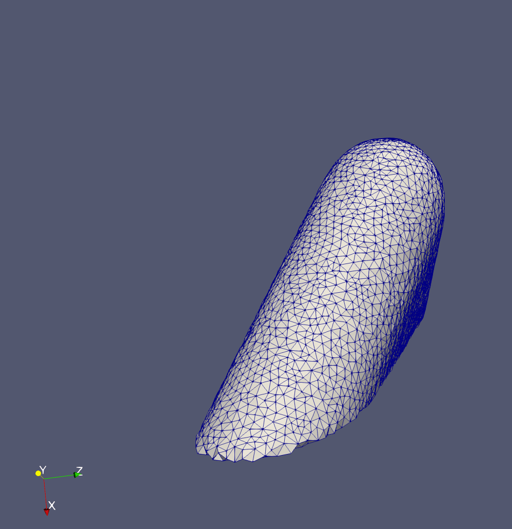

But when I output the whole c3t3 to unstructuredgridVtk by calling output_to_vtu(c3t3) it is nicer (the way Delaunay Refined 3D Mesh should look like) and not like the mesh I obtained from
manually outputting the info.
Is there any way to extract all the facets (not just the boundary facets) that belong to tetrahedra of C3T3::Triangulation? What I am doing is following:

Am I missing something? That is needed to be taken care of?For sake of clarity I am attaching two pictures with this email.
Manual Output:
Output to vtu:
