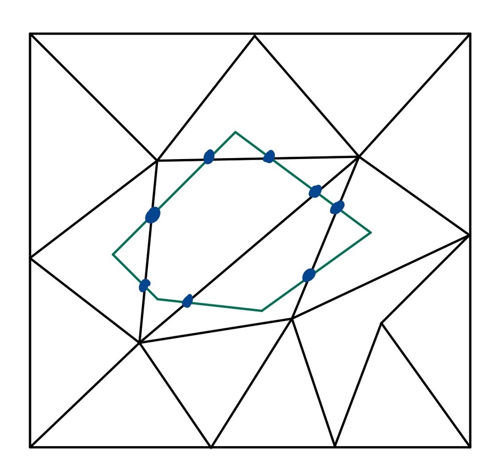

You could use the Line_face_circulator
Best,
Andreas

I’m trying to see if it’s possible to use CGAL to
perform the intersection between a mesh and a (closed) curve
inside it. This curve has co-dimension 1, and I’m assuming
it’s just the union of segments given by straight lines
connecting its support points, which I know of course.
Basically my goal is to compute the coordinates of
the blue points as in the attachment. As I am new to CGAL, I’d
like to understand how you would attack the problem.
