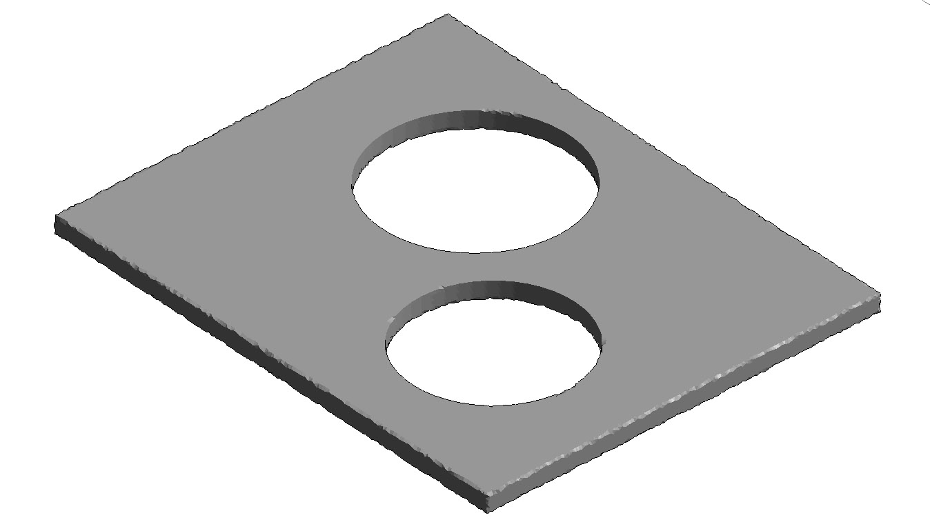

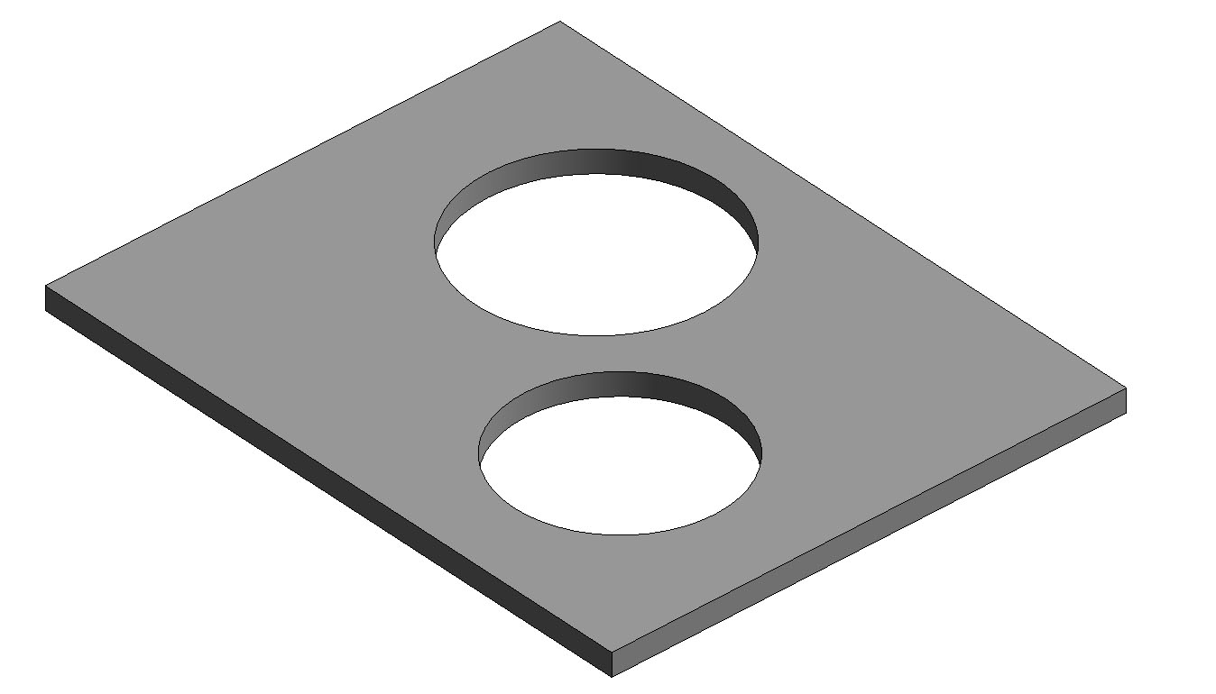

hello. I follow this example,but full of bumps and hollows;
this is my code
std::vector<edge_descriptor> border;
PMP::border_halfedges(faces(mesh), mesh, boost::make_function_output_iterator(halfedge2edge(mesh, border)));
typedef boost::property_map<Mesh, CGAL::edge_is_feature_t>::type EIFMap;
EIFMap eif = get(CGAL::edge_is_feature, mesh);
PMP::detect_sharp_edges(mesh, 60, eif);
int sharp_counter = 0;
for (edge_descriptor e : edges(mesh))
if (get(eif, e))
border.push_back(e);
++sharp_counter;
PMP::split_long_edges(border, edgeLength, mesh);
PMP::isotropic_remeshing(faces(mesh), edgeLength, mesh,
PMP::parameters::number_of_iterations(numberOfIter)
.protect_constraints(true));
