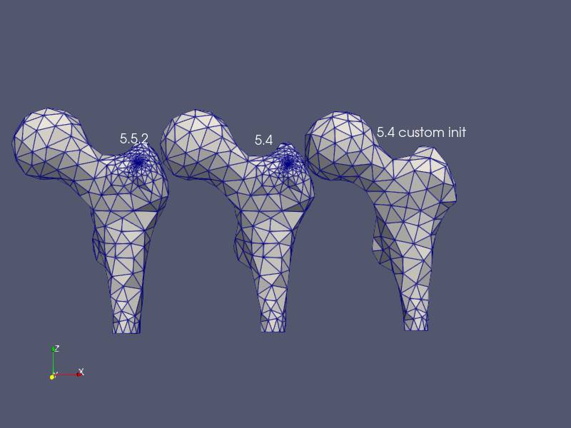

I tested this now in 5.5.2 (according to github it should be in there as well?) but I cannot see any difference to 5.4 - except when using the custom init (see attached image). Code is still this one: https://gist.github.com/reox/0df1f446f0ff9d46e0688b60e8e858b8

On 25.05.2023 08:15, Jane Tournois wrote:
Hello,
this local over-refinement issue has been fixed in the master branch by the following pull-request :
https://github.com/CGAL/cgal/pull/6978
Which version of CGAL are you using?
Best,
Jane.
