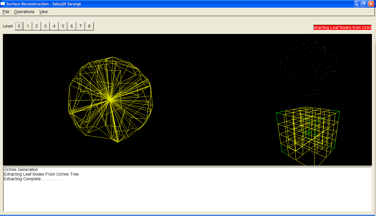

I am still having a problem when extracting the infinite cell. When trying to extract the triangles from the infinite cell, I tried both the incident cell approach as well as by iterating through all the cells and then taking into consideration only the infinite cells. Still the result seems to be the same in both the cases.
// Loop through all the cells to find the infinite cells
allCellIterator celliteratorbegin = p_DelaunayTriangulation->all_cells_begin();
allCellIterator celliteratorend = p_DelaunayTriangulation->all_cells_end();
while (celliteratorbegin != celliteratorend)
// Cells being iterated. All cells. Check whether a cell is infinite or not
if (p_DelaunayTriangulation->is_infinite(celliteratorbegin))
// Infinite cell is found. Now
cout << "Infinite Cell Found" << endl;
const int index = celliteratorbegin->index(p_DelaunayTriangulation->infinite_vertex());
Point3D pa = celliteratorbegin->vertex((index+1)&3)->point();
Point3D pb = celliteratorbegin->vertex((index+2)&3)->point();
Point3D pc = celliteratorbegin->vertex((index+3)&3)->point();
// This portion is for my own data structure and can be ignored.
// Add the triangle to the Triangle list
Point p1(pa.x(), pa.y(), pa.z());
Point p2(pb.x(), pb.y(), pb.z());
Point p3(pc.x(), pc.y(), pc.z());
cTriangle *T = new cTriangle(p1, p2, p3);
TriangleList.push_back(T);
++celliteratorbegin;
I don't understand why the triangles somehow point to some interior point of the point cloud. I mean the interior triangles. Essentially it should be the convex hull but thats not what I am getting. I am only including the triangles which are in my "TriangleList" for rendering. Please see the screenshot attached. Laurent, I will definitely try out the convex hull approach but I am trying to see if one of my filtration algorithm works on the delaunay and hence need it. I know its an overkill but right now I have to see both the approaches.
