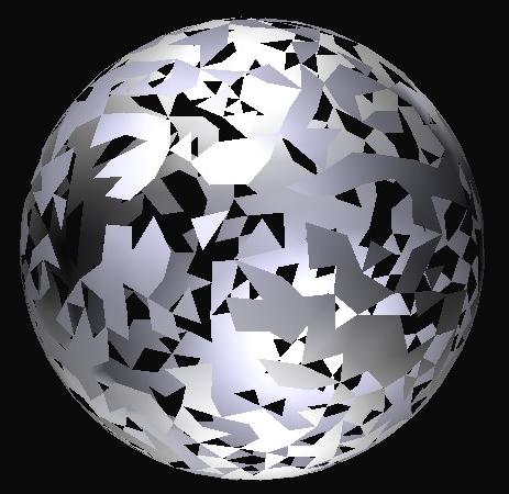

Hi,
I am a newbie of CGAL, and I tried CGAL 3.5 release these days. WinXP on 32bit machine; MSVC2008.

I tried “mesh_an_implicit_function.cpp” again. From “mesh_a_3d_gray_image.cpp”, I copied the code needed to output the mesh to off file. The problem remains, as seen in attached “out_sphere.jpg”.
Actually, I tried with CGAL-3.4-Setup.exe today, and I got the same results. The meshes look ugly with many holes, which is quite different with that in the manual.

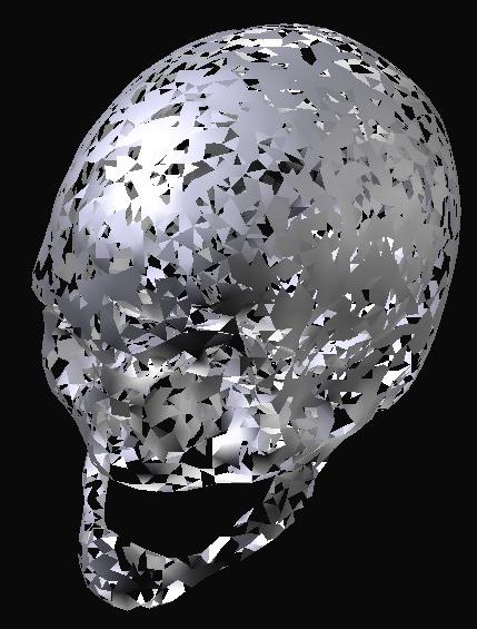

I made the VC projects with command “cmake-gui” following the installation guide. After all red entries being removed, the IDE targets were generated with variables of “WITH_examples”, “WITH_demo”, “WITH_GMP” checked (ON). Then, I open the generated “CGAL.sln” and compile it. Four libs were generated successfully except CGAL_Qt3 and CGAL_Qt4. I just leave the two CGAL_Qt libs aside, since I am just interested with the surface mesher example.
I then run the example with the “mesh_a_3d_gray_image.cpp” without any
modification made to the original code. The output “out.off” is at
attached. After removing the third empty line in the off file, the
mesh
is visualized as attached “out_grayimage.jpg”. As can be seen, there
are a lot of holes on the mesh (I don't think they are caused by back
face culling since there is no triangle at the holws if I show the mesh
in the mode of wireframe).libQGLViewer-installer.exe,
