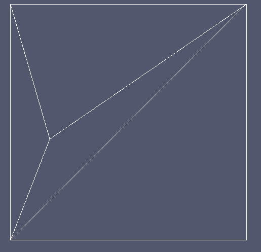

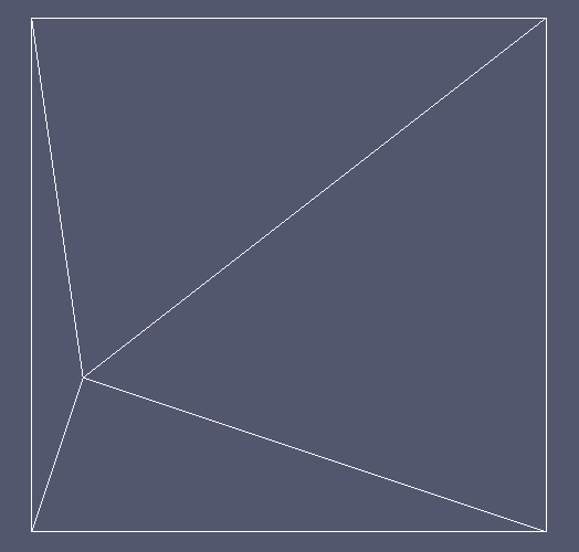

I was testing the move method of CDT and I got a triangulation that, I think, brokes the Delaunay property, please correct me If I am wrong.
I had this code:
int main()
  CDT cdt;
  Vertex_handle va = cdt.insert(Point(0,0));
  Vertex_handle vb = cdt.insert(Point(0,10));
  Vertex_handle vc = cdt.insert(Point(10,10));
  Vertex_handle vd = cdt.insert(Point(10,0));
  Vertex_handle vm = cdt.insert(Point(1, 3));
//this gives the Figure1.
  cdt.move(vm,Point(1.66667,4.28571));
// now the triangulation changed to Figure2.
  return 0;
Figure1
Inline image 1
Figure2
Inline image 2
The face on the bottom right, and the one next to it, I think they both break the Delaunay property.
Is this ok? or what should we do? Please help.
