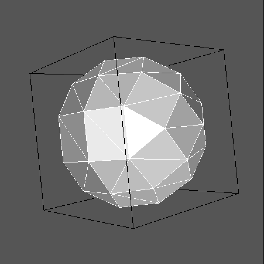

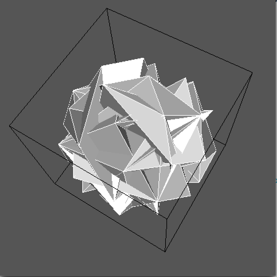

no, i finally convert to convex hull from triangulation, because when i visualised the triangulation, it was not what i had thought it was (attaching a visualisation of the triangulation of the point, as well as the extracted convex hull (which was what i am after). the triangulation doesn’t even look alright to me ( i output all the finite vertices, edges and facets in off format)…however, the convex hull comes out just alright. it is clear that not all the simplifies of the triangulation are a part of the convex hull, so just taking the simplifies incident to the infinite vertex or cells in the triangulation and think it give the full convex hull was a wrong idea…i was getting bad results then. by the way, is it true that a simplex that belongs to convex hull may actually not be a part of the triangulation?
also, more importantly, when i output the infinite vertex it gives me the coordinates as (0,0,0). i faintly remember reading in the coal manuals that for points on sphere, there is an insertion of a dummy point at (0,0,0)…just trying to confirm. if this is true, i can partially make sense of the garbage result i was getting.
so now, i convert to convex hull, and write it to a polyhedron_3. by the way, i think i have my answer. the halfedges are unique to a facet from what it looks like on the polyhedron documentation.
