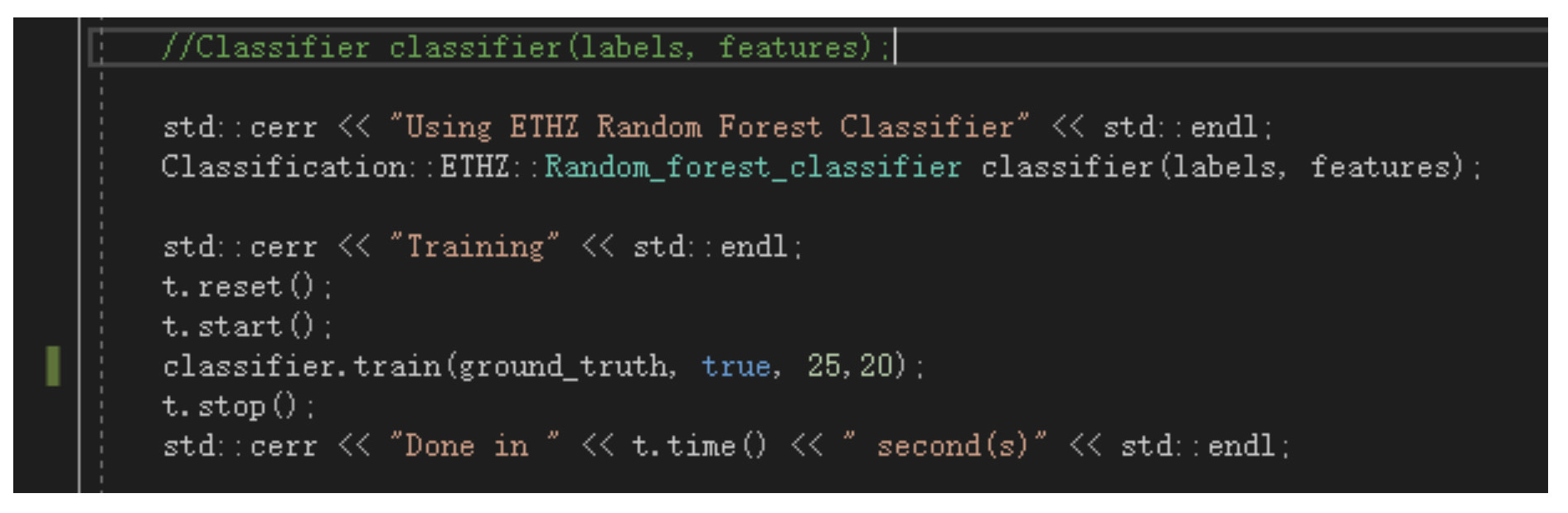

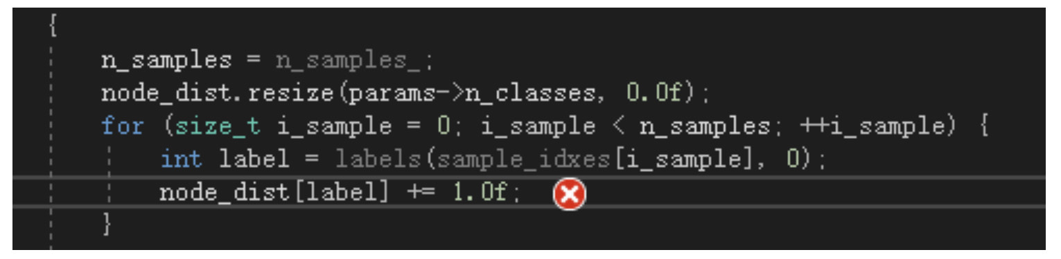

Dear Simon,Thanks for your kindly reply. After reading your demo codes, I have already fixed several errors due to the file format. Now the problem occurs at the training step, where the break point locates in node.hpp from the ETHZ random forest package. If I use the example training dataset, everything is ok. However, when use my own labeled point clouds, it encounter such errors.So may I ask whether there is a specific definition of the format of the training dataset? In my dataset, everything point has a label in terms of integer number, denoting different classes. In your example dataset, just part of points are labeled and others with default value -1. Then I am just wondering, isn’t it allowed to give a fully labeled dataset to random forest? Or perhaps any other reasons?Thank you again for your help.Regards,JinweiDear Zhang,

At this moment, I am stopped at this training and classifying step because of these confusions, even though I have my own training datasets. I really need your help and would appreciate for your explanation.I'm doing my best to figure what's going on, but it's very complicated to help without seeing the actual code (not just 2 lines copied in a mail), the cmake output or the actual error. The screenshot of the breakpoint comes from a deep code in Boost and is not related to CGAL, the problem probably comes before that.
If you can provide more information I can investigate more.
