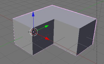

I have been writing some programs that use the Nef_polyhedron_3 and
Minkowski_sum_3 portions of the CGAL library. I have discovered a number of assertions with various input shapes. The attached backtrace shows one example problem. I have also attached a small example program, and the input shapes. The l-shape is shown in the attached jpeg file.
This problem shows up in both CGAL 3.7 and 3.6.1. I am using GCC 4.5.1
on Arch Linux with kernel version 2.6.36.
I think this is a bug, since it does not occur with other input shapes. I would be very grateful if someone can help me fix it since the Minkowski_sum_3 is essential to my research.
Thank you for your time.
Jason M'Sadoques
Description: JPEG image
