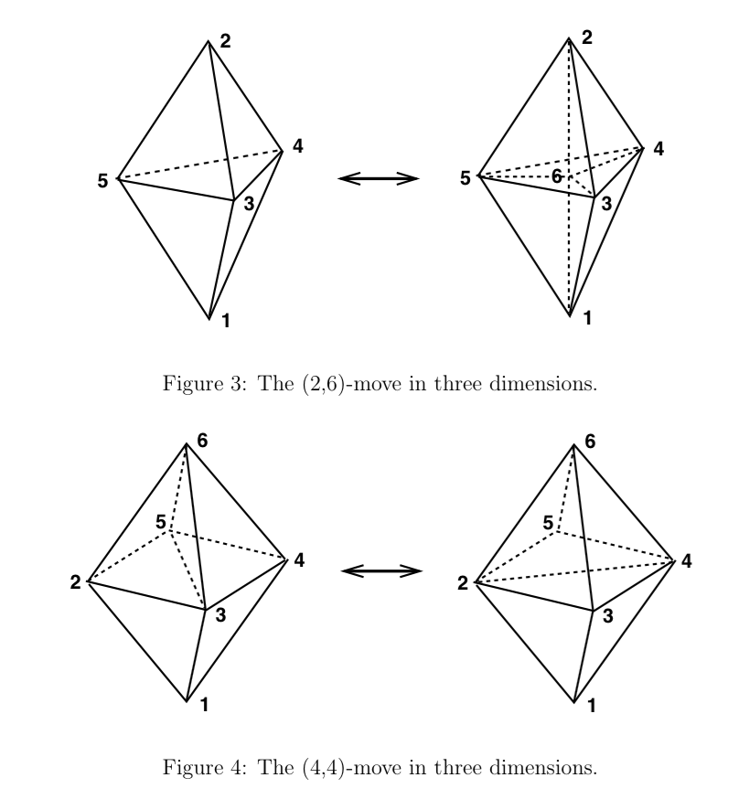

Hi Monica,
Thank you for your reply.
It looks like "flips" implements the (2,3) and its inverse, but not the (2,6) and (4,4) moves + inverses.
Thank you!
On Mon, Feb 2, 2015 at 1:07 AM, Monique Teillaud <> wrote:
Hi,
Look for "flips" in
http://doc.cgal.org/latest/TDS_3/classTriangulationDataStructure__3.html
If it does not provide everything you need, we could add more in CGAL.
Best,
