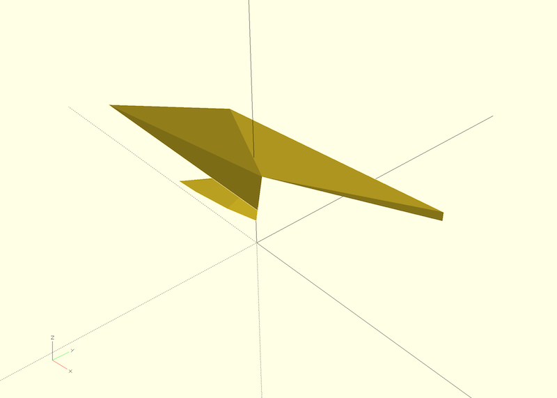

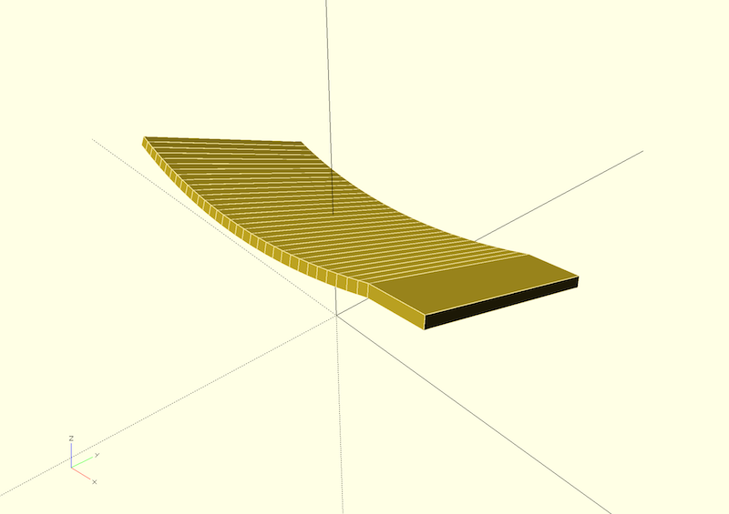

Marc is right. Could you try with the following patched file?With the patched file, it no longer throws an exception.
However, it also doesn’t correctly calculate the hull.
See screenshot of my polyhedron before and after hull.
If necessary I can try to slim this down to a minimal test case.
In case, do you have a small demo/example program which I could modify to output something useful?
