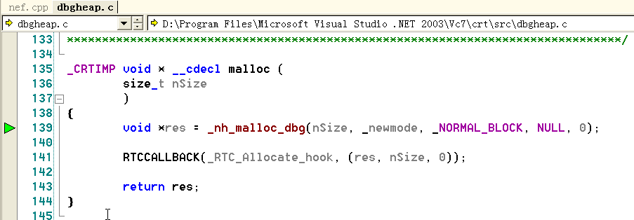

The program causes a runtime error, see the attached 1.png. (debug mode)
The program ceased at the position as shown in 2.png.
The whole project I'm using is also attached.
