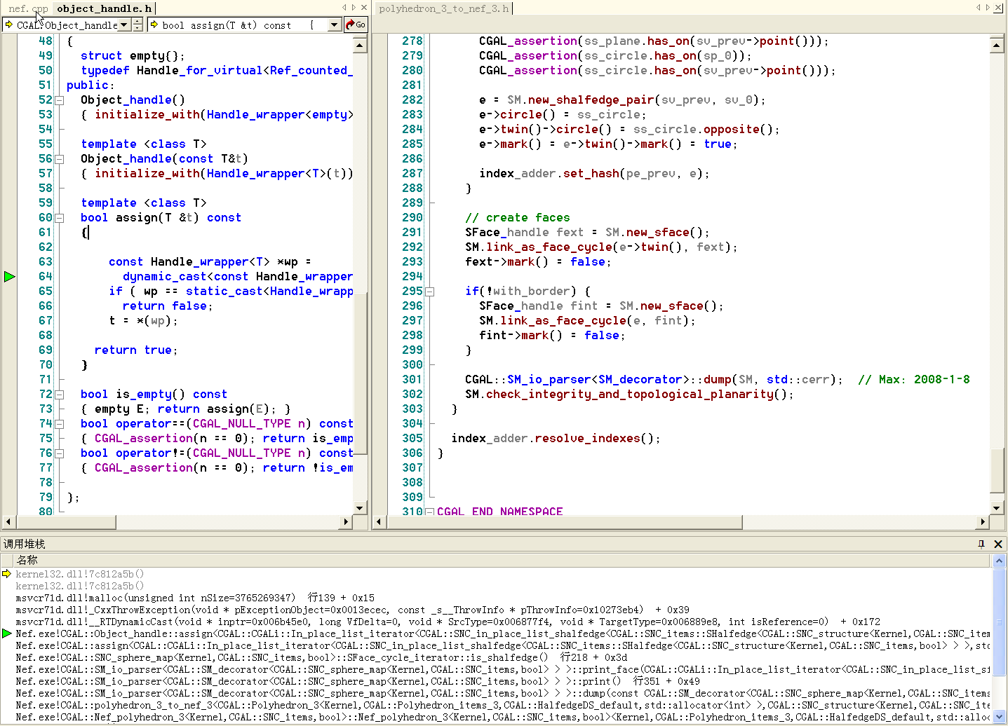

I've made change as you suggested to polyhedron_3_to_nef_3.h(not
polyhedron_to_nef_3.h).
The program's output before error occur is as dos.png.
The context at the stop point is as snapshot.png.
The 2 files are as attached.
Thanks for your help.
B/Rgds
Max

Looking at the latest debug picture 1.png, we can try the following
stuff:
The programm stops at an integrity check of the data structure. I want
to check whether the data structure really lacks integrity or whether
its something else. Please add the line
CGAL::SM_io_parser<SM_decorator>::dump(SM, std::cerr);
in front of the fifth line from the end in polyhedron_to_nef_3.h, which
looks as follows:
SM.check_integrity_and_topological_planarity();
So that it looks like
index_adder.resolve_indexes();
at the end of the file. Then compile and execute your program again and
send me the output, please.
