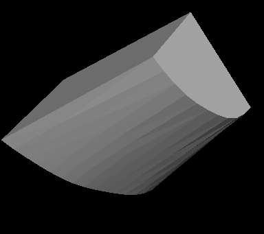

Hello,
It seems that I probably have not understood CGAL::Nef_3 well,
for I just keep coming across problems with it.
Here's still a simple question/problem related to Nef_polyhedron:
I'm reading a closed polyhedron and then convert it into a Nef_3,
the code is as this:

Nef_polyhedron_3 N1(P1); // convert to nef
cout << N1;
The program ceased, under debug mode, at assertions.cpp:

and seems to be called by converting P into a Nef_3.
I'm using CGAL 3.3.1+WinXP/SP2+VS2005/SP1.
the .off file is attached.
Please tell me what's wrong.
