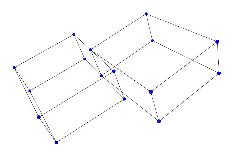

Thanks for the data.
That's not what I expected when you mentioned almost identical polylines.
Did I extract correctly the data?
Thanks,
Sebastien.
On 08/24/2015 02:05 PM, Bryn Lloyd wrote:
Dear Sebastien
I attached the surface and polylines as code sample (C-arrays), but can
also provide other formats if that is easier for you.
Thanks & best regards

On 08/21/2015 09:17 AM, Bryn Lloyd wrote:
Dear list
Is there some way in CGAL to merge nearly identical/overlapping 3D
polylines?
For instance if I would have two polylines of the same circle but
faceted slightly differently: is there I way I could with a specified
(distance error) tolerance, merge these 2 polylines into one or detect
that they are "identical"?
A more complicated example is two squares sharing one edge, but faceted
differently along the shared edge.
The goal of this operation is to remove problematic 1D features for 3D
mesh generation.
Bryn
