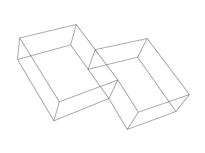

Thanks for looking at the data. Yes, you extracted the data correctly.
I am working on a few "test cases", one where the cubes are aligned and
one where the cubes are nearly aligned, and maybe touching...
Thanks
Bryn
OK so in your context, a polyline is a set of protected edges, correct?
Would you expect to get the input polyhedra modified as displayed in the picture attached?
