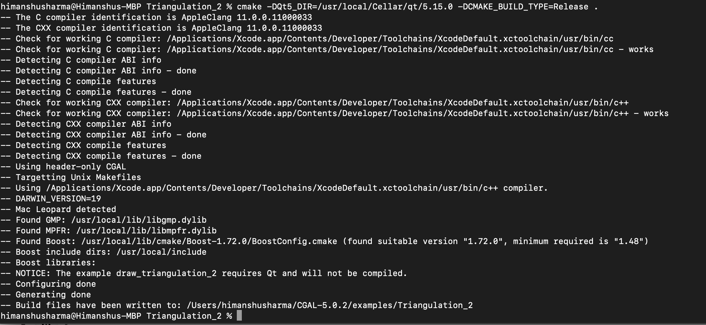

Sure.
Attached the file along.
I ran the following cmake command for configuring.
cmake -DQt5_DIR=/usr/local/Cellar/qt/5.15.0 -DCMAKE_BUILD_TYPE=Release .
Regards
Himanshu

Hi,Did you configure the example with cmake ? Did you specify a path to the Qt5 directory ? Can we see your CMakeCache.txt file, generated in your build directory ?Le mar. 23 juin 2020 à 19:41, Himanshu Sharma <> a écrit :Thanks for your reply.I do have qt installed in brew environment. However when I try to compile examples in Triangulation_2, and I get the error message:NOTICE: The example draw_triangulation_2 requires Qt and will not be compiled.
Have attached the screenshot, if it helps.

The review process in homebrew has decided to remove that package cgal-qt5. It
is sufficient to install `cgal` and `qt` in homebrew, to get the features of
CGAL_Qt5.
